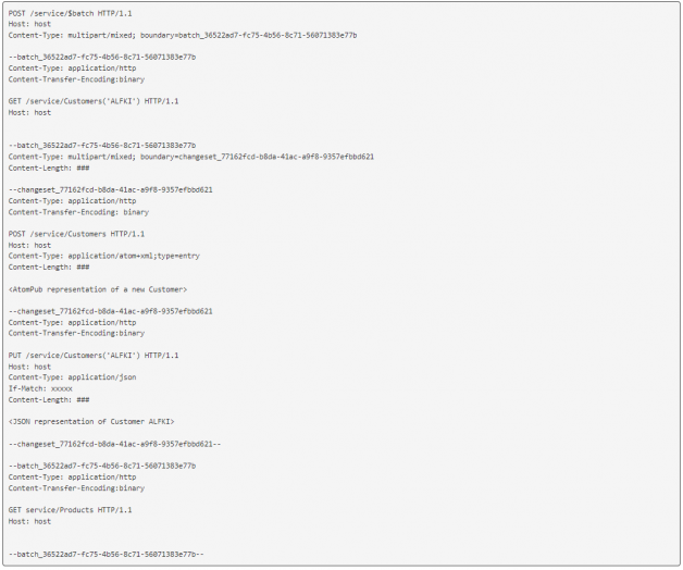

The example above shows a sample batch request with the operations as follow:  Retrieve → a change set that contains the following requests: Insert and Update → a second retrieve request
Source: https://www.odata.org/
